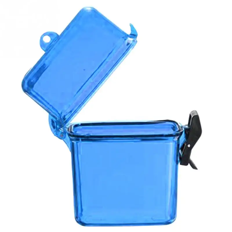

I've also used a few of the waterproof cases found in the camping/hiking area of the local Walmart... these are intended for matches, cigarettes, cellphones ... anything to keep dry while boating or camping outdoors. They are in various colors, but the light blue or clear ones are great and the water seal is fairly substantial. I often find these in the surplus $1 store, but not as good of a quality.

Yeah, the MM is thinner but longer, I think I will pick a few up, cheers.
