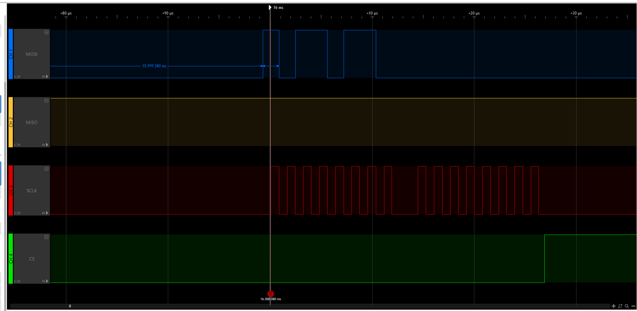

nevertheless, I tried your sketch on my nucleo_L476RG, and everything look fine:
I put an logical analyser on the 4 SPI pin and get the expected signal.
On SCLK, I got 8 pulses, sending REVID address to read On MOSI I can decode 0xB6 = 0x80 for read + 0x36 (=RM3100_REVID_REG)
Then 8 new pulses on SCLK for read value but of course nothing on MISO as I have no sensor connected.
CS is driven low during the whole operation.
So everything looks good.

Posts: 507
Re: Problems with SPI (Nucleo L476RG)
@jh2399 , if you're using multimeter, then you won't get any useful data. You need something that can detect high frequency signals.
As you can see on graph from data analyzer, there was only about 25us (microseconds, not milli) burst on SCLK.

GonzoG wrote: Thu Aug 04, 2022 10:05 pm @jh2399 , if you're using multimeter, then you won't get any useful data. You need something that can detect high frequency signals.
