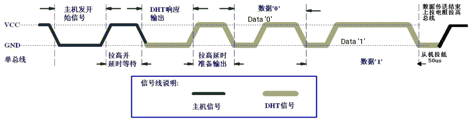

1. that chart is wrong as the master (mcu) pulling down the bus at end of the start signal. it should be pulled down by the slave (the device).
2. in reading the device, what matters is just the duration of the positive pulse from the slave. so something like this should work.
that is actually from the datasheet, the solid black pulse at the beginning is the start signal (i.e. sent by MCU).
Then the brown signals are the data signals from DHT11/DHT22, so indeed, the DHT11/DHT22 is controlling the line after the initial start signal pulse from the mcu.
the datasheet is likely wrong there. Chart 3 shows that the slave pulls down the bus instead. it is likel that this is an open-drain configuration. so the high state of the start signal is simply the master let go of the bus.
